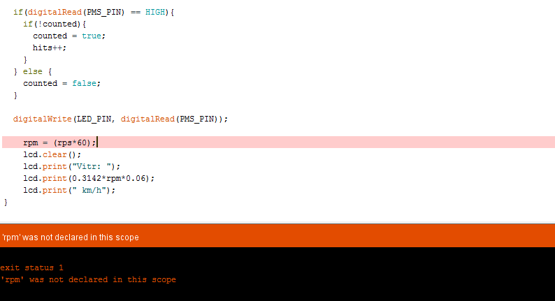

Aleš: zdá se, že závorek je tam dost, vzorec jsem upravil, ale píše mi to, že „rmp“ není deklarované.
exit status 1
‚rpm‘ was not declared in this scope
http://fii.cz/zxfbym// Compute the RPM of a simple DC Motor using a photomicrosensor(PMS) #include <Wire.h> #include <LCD.h> #include <LiquidCrystal_I2C.h> #define PMS_PIN A0 // Pin for signal from Photomicrosensor #define LED_PIN 13 //Using Arduino's Internal LED; just as an indicator boolean counted=false; int t1=0,t2=0; int hits=0; int rps=0; LiquidCrystal_I2C lcd(0x27,2,1,0,4,5,6,7); void setup(){ pinMode(PMS_PIN, INPUT); pinMode(LED_PIN, OUTPUT); lcd.setBacklightPin(3,POSITIVE); lcd.setBacklight(HIGH); // NOTE: You can turn the backlight off by setting it to LOW instead of HIGH lcd.begin(16, 2); lcd.clear(); } void loop(){ t2 = millis(); if(t2 >= (t1 + 1000)){ rps = hits; hits = 0; t1=t2; } if(digitalRead(PMS_PIN) == HIGH){ if(!counted){ counted = true; hits++; } } else { counted = false; } digitalWrite(LED_PIN, digitalRead(PMS_PIN)); rpm = (rps*60); lcd.clear(); lcd.print("Vitr: "); lcd.print(0.3142*rpm*0.06); lcd.print(" km/h"); }Bojkas
